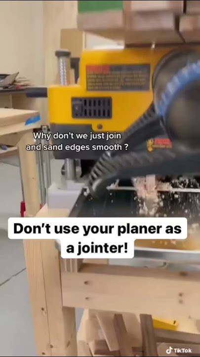

You said face jointing, but you mention keeping the board on edge as
You said face jointing, but you mention keeping the board on edge as it goes through a planer … so do you mean edge jointing?
Yeah I'm specifically talking about face jointing, I can edge joint fine on my table saw with a tapering jig.
I do have one of these jointer planers that you are linking here from veritas. Although I've never manually flattened boards before and was hoping to use a planer sled to get faster and more consistent results.
