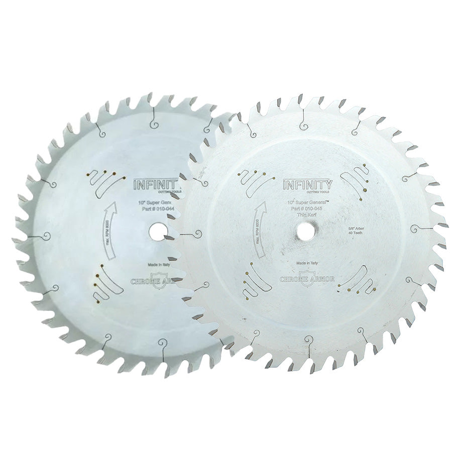

Infinity makes a great blade for 1/2 that price:

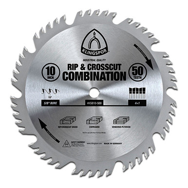

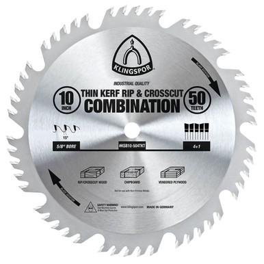

The combo blade has 50 ATB teeth:

You would have better performance when ripping with the 40 tooth blade.
