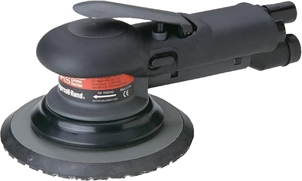

This Ingersol Rand sander uses 17 CFM according to the product description:
That's more air than even a 5 HP compressor can deliver, depending on the pressure.
This one is double the cost but takes 1/2 the air, only 8 CFM.
What's the difference?
I think the specs on Amazon may be a little suspect. It also says the 5141 AC adapter current is 8 amps.

I was asking "What's the difference".?
It baffled me as well, when iI said it has an 8 AMP rating.
No air powered sander I seen or used need an electrical connection!
Is the issue with Amazon and it's "write up" specialists?
I have an old air powered sander, it may be an Ingersol Rand? I'll need to run out and look.
