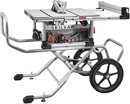

#30 ·
Also note that modern premium blades often have ground blades, rather than milled blades. The milled blades have teeth that are offset alternately to the right and the left. This helps prevent binding and burning of the cut. The ground teeth are all in line and offer a better, smoother cut. You do have to watch your feed rates. Too slow will burn the wood and too fast will too. You have to hit the sweet spot where the blade is cutting without too much "push".
