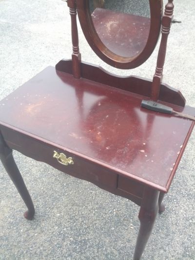

Also this vanity for my girlfriend. I'm wondering if there is a chance I could match the color, if I could only redo the top and leave the rest. What do you think? How should I strip that?

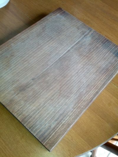

Last one, I made this walnut cutting board last year. It is actually only two pieces of quarter sawn black walnut my dad had laying around (he has a wood shop). Literally glued them together, sanded then used mineral oil and bees wax to coat. I want to make it into an end grain cutting board, so I would be cutting it width wise then re-glueing. How should I remove the mineral oil or will it glue fine with a light coating on it? You can see that it needs another coat, which I won't be applying. This wears off every few uses and I usually reapply once a month or so. It's been a while and it was just washed. Also has a nice water mark from a roommate last year.

The coffee table and vanity I would strip outdoors in good ventilation using Kleen Strip paint and varnish remover. There is a high likelyhood there is silicone contamination on the vanity. It might go easier for you if you would wash it down with a wax and grease remover such as Dupont Prepsol Solvent prior to stripping. The stripper a semi-paste remover so it's pretty thick and will stick to verticle surfaces. You apply a thick coat of the remover on and let is soak for 15 to 20 minutes retouching the places that might dry. Try not to do too much of it at once because the stripper is bad to evaporate. Once the finish is liquified then scrape the finish and remover off with a broad knife. Be sure to make sure there are no burrs on the broad knife to scratch the wood. Then as soon as possible after you get the finish off the residue left will need to be rinced off. You can use lacquer thinner with rags to clean the residue off frequently changing rags. It's important to get the residue completely off because the remover contains waxes which will interfere with the adhesion of the new finish. The residue can also be cleaned off with water. I use a small electric power washer that has only 1500 psi to rince the residue off. It will clean the furniture cleaner than anything you can use. I've stripped hundreds of pieces of furniture and the power washer does absolutly no damage to the furniture. The picture isn't clear enough to tell if the vanity is mahogany or just stained to like mahogany. If it is mahogany I would recommend using a pastewood grain filler to fill the grain. Sherwin Williams has a good one however it only comes in natural. They can add color to it to where you should be able to stain it and fill the grain in one step.
The cutting board I would recommend starting over. The mineral oil soakes too deep in the wood to really recycle it. I believe you would have trouble getting glue to adhere to it even if you thoroughly washed it down with acetone.
That's fine, wasn't my biggest concern, it works fine how it is now.
