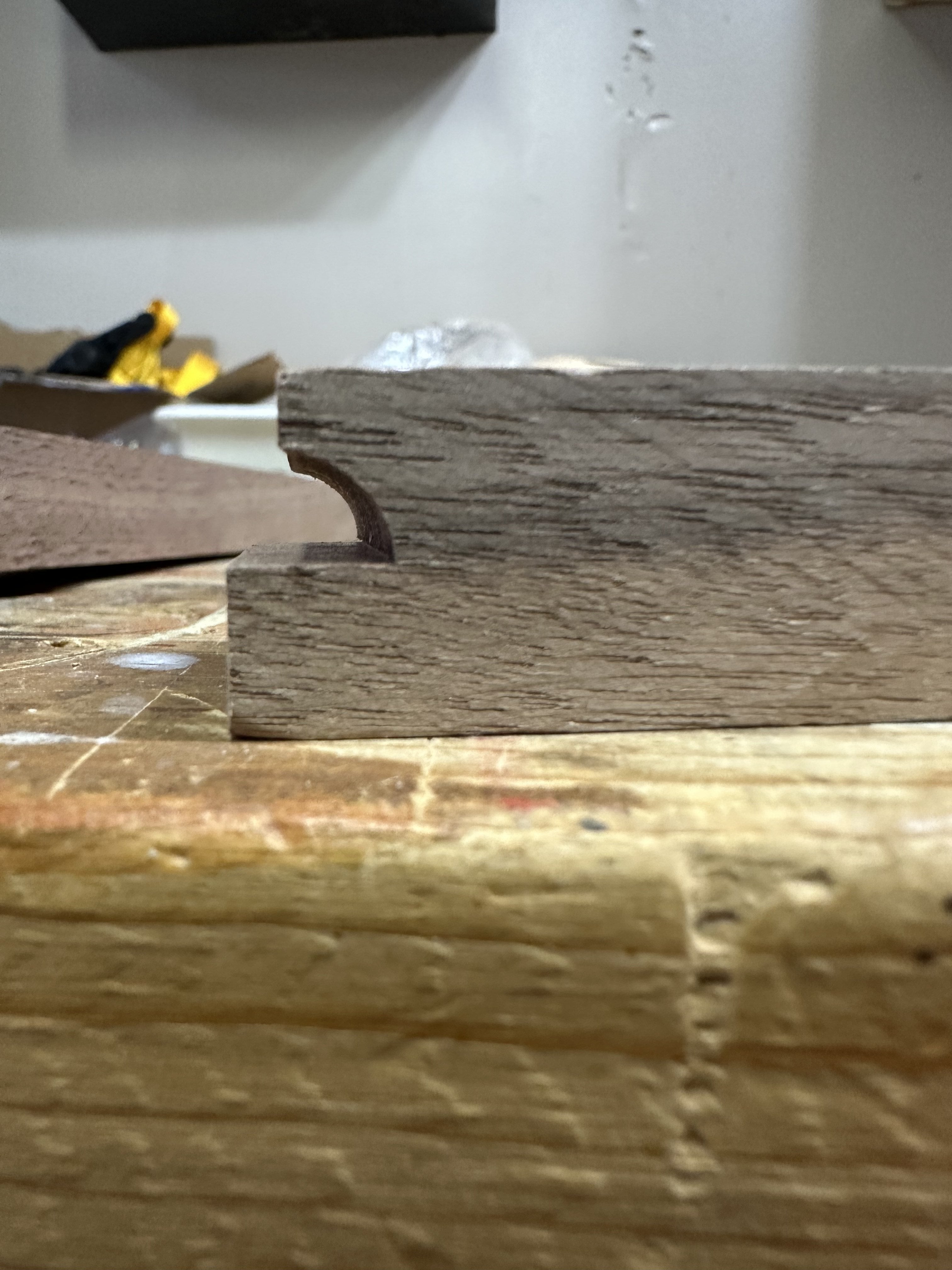

im trying to find some specifi Router bits that can makes these kind of cuts.. I’m pretty sure they are for rail and styles, but I have no a clue which ones they are.
I’ll be using it wood to create some simple picture frames. I know I can get a new chop saw and cut 45s and any other of a number of ways. But I want to just start making my own this way.
im actually a portrait painter and use these to frame my work. I was getting unfinished oak frames from an Amish guy and finishing and staining them myself to compliment the art.. but he‘s dissapeared
. i was able to tear one of his frames a part and this is what I found. I figured I could make these myself. I have the basic tools.. just need to figure out which router bits to get.. I’d be really grateful if anyone knows and could tell me !
There might be an alternative but it looks like a two part ogee stile rail and stile bit might work. You would have to remove the groove cutting part. The rabbets you would have to plow with a straight bit or table saw.
I've removed half the slot part of the bit to illustrate it better.
It looks kind of like a rule joint, so you could research how those are made with a half round and box core bit.

Now seeing the rest of the frame, it does "make sense"!
It does make for a "butted corner" look, but it's likely very strong.
If you're convinced that joint is what you want? be aware the making that section/profile on the end of a 2" to 3" wide piece will require a very stable support for the workpiece. It will want to tear out the end grain as it completes the cut, so a "backer" is required making a zero clearance support.
Typical 45 degree "miters" do not have that complication and they can be easily splined for strength.

This is essentially a glass door profile. You can also do it with a door profile which leaves a slot. You assemble the door frame and then rout out the remaining back to reveal the rabbet. I do this all the time and have a router bit modified a bit to accomplish it. It's just a 1/4" bottom bearing flush cut bit and I have to grind the screw flat that holds in the bearing so it can get down far enough to make the cut to remove the remaining stock that forms the slot. Once it's removed you have a rabbet and all you need to do is square out the corners which is easy because the 1/4" flush cut bit only leaves a 1/8" radius round.

Assuming it's a "look" that you're after? Rather than a particular process or method?
The appearance of that joint is much like a half lap, also a very strong joint.
Half laps can be made with a hand saw, a dado bit in a router or on a table saw or with a bandsaw, as I normally do.
Your woodworking projects will be limited by the limited type of tools you have.
Getting more serious about woodworking will mean getting more tools and machines.
The door joint bit set is about your only method at this point.
Unless you consider using the half lap with the router?

As far as the glass groove is concerned….
We will take this carbide bit and grind down some of the radius at the end so it first in the groove to cut out the excess. You can go in the correct direction, but we usually go backwards and route most of the meat and go back in the correct direction to clean it up.

Yes, definitely made with a rail and stile bit, or bit set, intended for making cabinet doors. That's a pretty simple one; you can find them with ogee or other compound curves. They come in two types. The one Steve showed has two separate bits, one for the concave and one for the convex profile. The biggest hassle involved with these sets is getting the height set properly. Tip: put a tight-fitting cheap neoprene O-ring on the shanks of both. When you have the height set correctly, slide the O-ring down against the router collet as a guide for the next time you swap bits. I have, somewhere, a single-bit set that also requires taking the bit apart to re-stack the cutters when changing from one profile to another, adding another hassle to the process. I don't use that one much.
