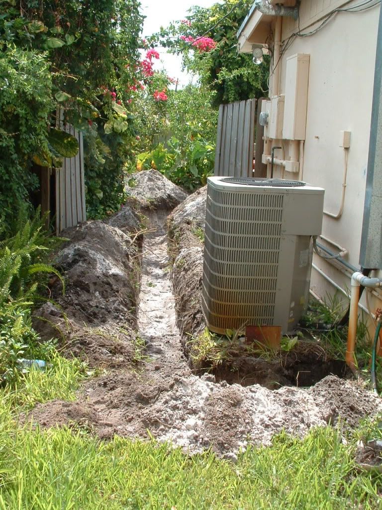

This picture was taken when I had the trenching dug to hook up to the sewer. You can see the gates in the background.
