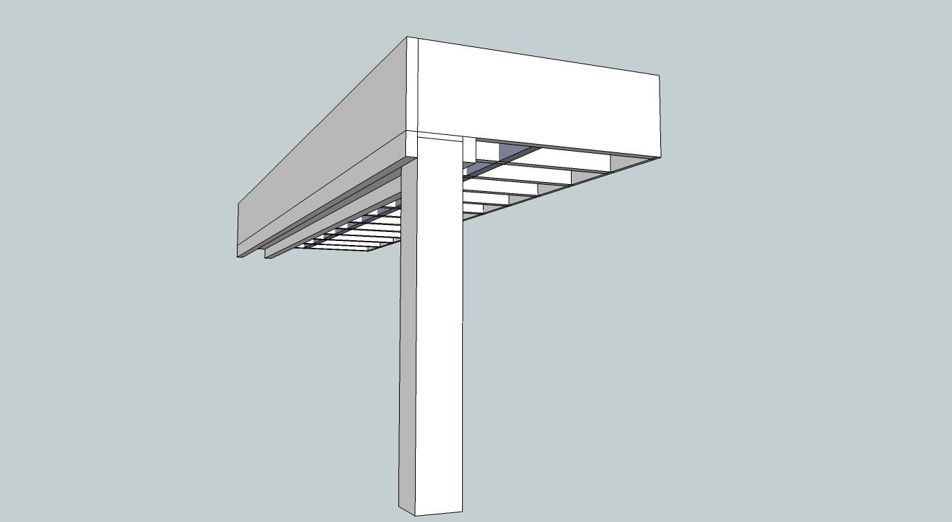

More than just that, the connection of the legs is really weak :eek: You are asking those two small pins to carry all of the weight down thru the leg. Even if the pins were made out of steel, the load could possibly tear through the hole in the wood that they sit in. I advise that you rethink your method of leg attachment. I would suggest making either an L bracket out of plywood or a u channel that spans the entire length of the table an have the leg rest inside the channel or bracket. Cross brace the legs so that they don't rack as well.
