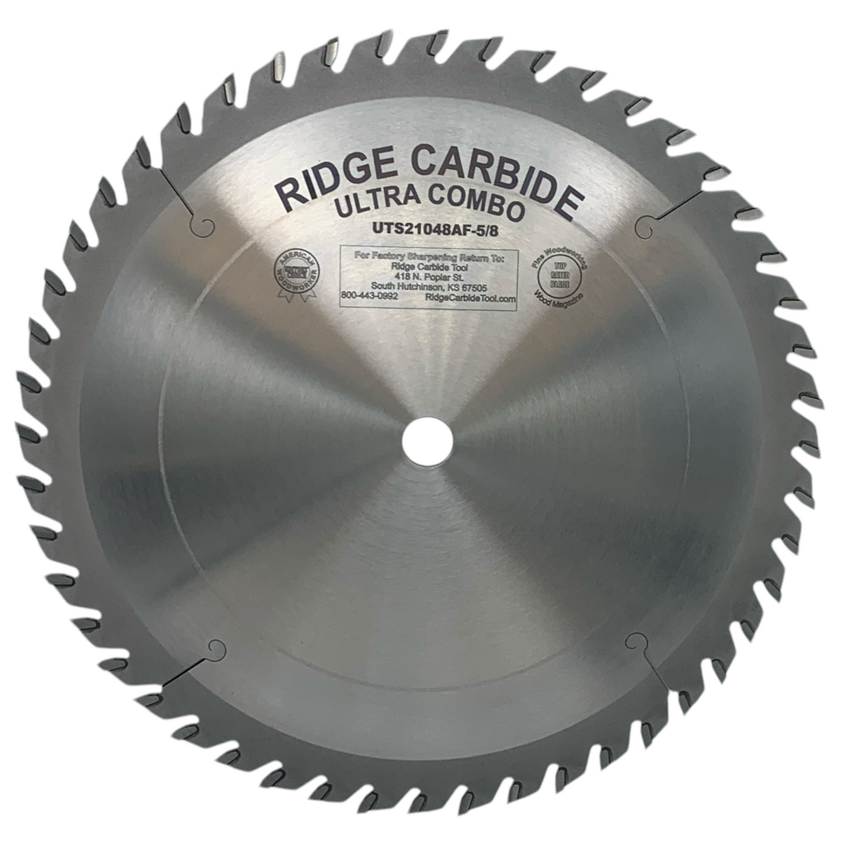

The important thing to know about any carbide blade is the type of carbide used on the teeth.
The lowest grade carbide used on saw teeth is C3.
The more expensive blades use C4:
C-4 Micro-Grain carbide tips 1/3 larger than the best known blades
Surprisingly, this cheaper, Harbor Freight blade also has C4 carbide teeth:
