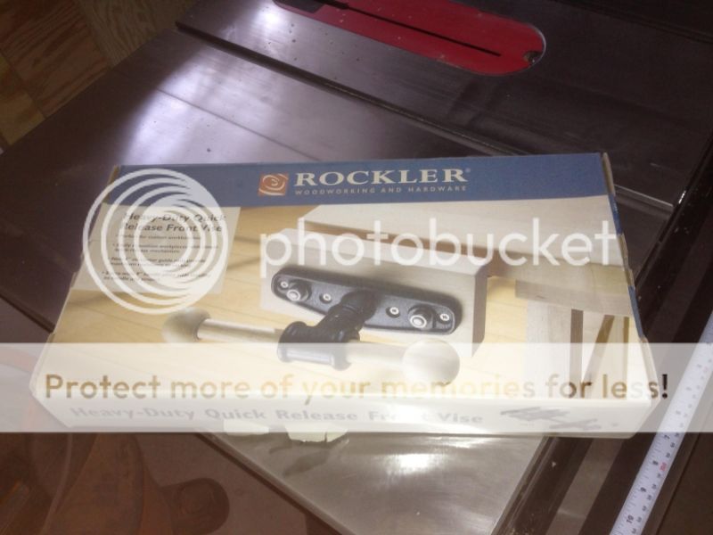

The major difference will be I am planning to use a Rockler tail vise instead of the Benchcrafted wagon vise and my dogs will be round rather than square. The leg vise will either be from Bigwoodvise.com or lakeeriewoodworks.com
