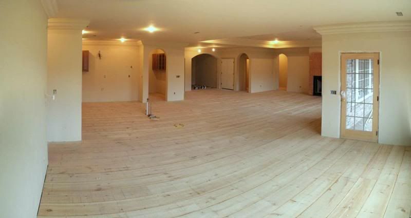

I know I haven't been around lately and I'm sorry but I have a good excuse. I've actually been quite busy. Within the last two weeks I've worked up by Kansas City and also built and delivered some cabinets to Denver Colorado. Just got back on Monday and had to go and finish a floor. Here are some pics of what has been going on. I don't have pics of the K.C. job because my camera crapped out but the homeowner is supposed to email me some.
Here are some pics of the floor we just finished this week.

Okay, I need a step by step on that floor. How'd you pull that off?
Great work.
If you tell me it was a special lens in the camera that bent the picture, I'm gonna be dissapointed.
Great work.
No special lens but the pictures are actually a bunch of pictures that have been put together to make one picture. It's called photo stitching and here is a link to the program that I use.
http://www.cs.ubc.ca/~mbrown/autostitch/autostitch.html
One of the pictures is actually 16 individual pictures that are stitched together.
edit: on a large stitch it does distort the picture a little.

JP, it's really not that hard, especially what I do. That floor is a 8" rough sawn white pine. I get my flooring from a local lumber yard already tongue and grooved for $1.85 a square foot. I install then lightly sand with a flooring orbital sander then stain, seal and 3 coats of finish with a sanding between the 3rd and 4th coat. It's not a perfectly flat floor and still shows alot of saw marks and rough grain but once the finish is applied it's as smooth as a babys butt.
