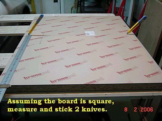

If you are professional, probably you have one of those "Guide rail", but if you are amateur like me...
The circular saw guide is very old "patent", so what's new....
I used "floor panels", slippery and strong (15 years guaranty), they come in lengths of 50" or 100", I used the 50" and 5/16" thickness.
Another improvement, that can work also with the "Guide rail" (I think), is using of knives for measuring and positioning to give maximum accuracy.
And the rest is on the pictures.
