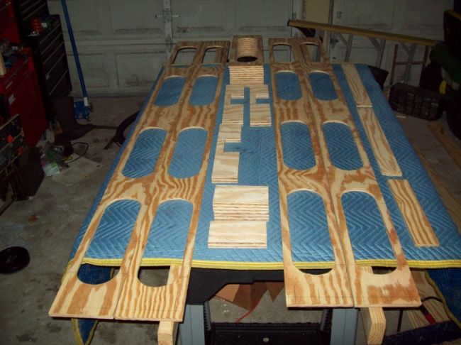

Hello, I'm new to this site as well as new to woodworking. I was needing a reason to buy new tools so I decided to give woodworking a shot. Since I didn't have anything to build a project on, I searched the www for work bench plans. I helped my son (12) build a small shelf last month and was no fum building it on the concrete.v After looking at several plans, I decided to go with the Paulk work bench. I finally have most of the pieces cut out and ready to start putting it together. The plans are nice and print in 11"x17" format. There is also a good series of videos on youtube that Ron Paulk made on how to build it. I am not too sure about the saw horses but I will wait and get everything else assembled before I try something else. I'll post pics of the progress as I put it together. Thanks, Steven

Cut-Outs:

Well, It should be STURDY when it is done. Looking GOOD so far! Man that is a lot of DRILLING!
Actually, drilling the holes wasn't to bad. One of the tools that I bought was a Dewalt router. I used a 3/4" spiral up-cut bit which made quick work on the holes. I stacked the two halves together and drilled the holes. Cut the drilling in half that way. Thanks, Steven
