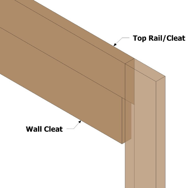

Would a french cleat system do it?
Something like this...
ETA... Google "French Cleat" then go to images. Theres also metal ones with a lower profile.

If you do decide to incorporate the mirror into a frame, I would suggest half-lap joints for the corners of the frame and the French cleat would be a good way to hang it.

Using a french cleat would still have to have a provision for mounting the mirror. Since the mirror is likely ¼", The frame would have to be at least 1¼" to have a ¼" edge covering the edge of the mirror, and a ¼" rabbet, and then the ¾" frame/cleat system, for the frame to be tight to the wall.
Thanks for all the guidance and help. The mirror will be set in a rabbit on the back side.
I will try he contact adhesive, think that sounds like my best option. I saw the steel style of French cleats, and had that in mind. But built this on a whim without pondering the fastening system with the need to be flush to allow the light fixture to be mounted to the mirror frame.
