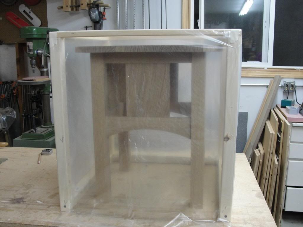

It's as simple as building a tent, finding a suitable location ( I fume out in my garden shed) loading your wood and fill a shallow non metallic bowl or two depending on how large your project is and seal it up and wait. Temperature does affect the fuming time I found, the colder it is the slower the process. I don't even look until 8 hours has passed, then I'll check every 2 hours if it's getting close.
here's a pic with my table in the tent for a trial fit.
And the final product, finished with General Finishes Armour Seal and Black Bison wax.
