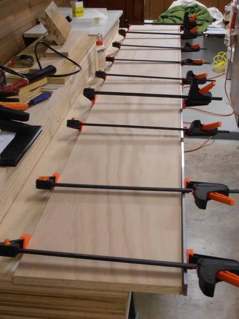

After all the good discussion and advise, I wanted to show the results. Here is the first board with the edging strip being glued to it.
As you can see, I did go with the 1/4" x 3/4" oak strips and I did use the cut-off nails. In spite of the fact that I inspected each trim strip in the store for any curves, I found that this one did have some significant ones. So it did need to be straightened as I glued it. I found that the nails do help keep it in place, but they also did allow some room to move it a bit. What I did not expect was that they will go deeper into the laminations of the plywood as the trim strip is clamped down. They started out protruding about 1/16" when I trimmed them with the cutters and wound up at 1/32" or less. This is probably why I was able to slightly reposition the strip while clamping.
I wound up spreading the glue with a 6" cotton swab: I keep packs of them in the shop for all kinds of uses and they were handy. And you just throw it away: no cleaning. What surprised me is I got no squeeze out. Not a single drop. I was really surprised.
I am using some inexpensive clamps (HF) as I knew I needed a lot of them. I had to remove the pins from the end of the bars to allow them to have a bit more capacity. I may drill new holes closer to the ends when I put them back. That is a 1/4" x 1" aluminum bar that I used to even out the clamping pressure. I needed more clamps than I first thought so it was a good thing that I bought a dozen of them. I bought about 10 more of a better quality and another aluminum bar so I can glue two boards at once.
One down and about 18 to go. With all the other demands on my time, I still will need some time to glue all of them.
Anyway, it appears to be well underway. Thanks again to all.
