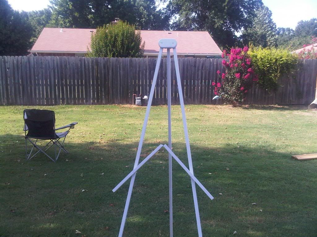

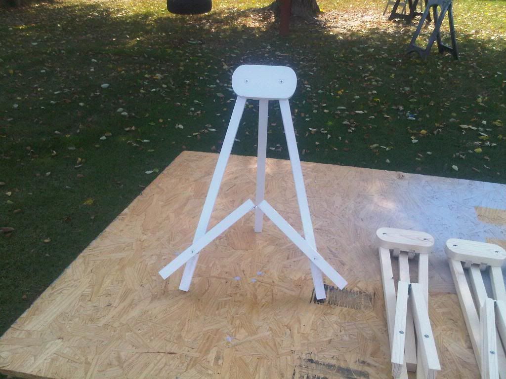

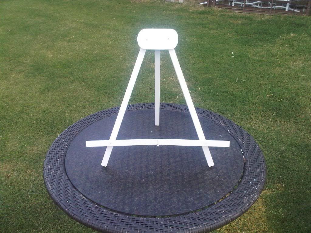

I was commissioned to make some folding easels. This is what I came up with...
All made from Pine garnered from discarded crates. Cost to make. $1.20 for hardware each (1 - 1" Hinge and 5 - 2" x 3/16" bolts & nuts) + 2 Cans Spray Paint $7.00
353 Posts
Yes I sell them. Unfinished $12.50 for the Desktop's and $25.00 for the Floor Model. Painted $15.00 & $25.00 I'll post a pic later of the the Head Piece. It's a piece of pine 2 1/2" x 5" with Rounded Corners and two half moon pieces dado'ed into the main piece. Desktop legs are 3/4 x 3/4 x 18" and center brace is 16" Cross Piece is 2 pieces 1 1/8" x 3/4" x 9" with a 1" hinge connecting them. Floor model Legs 66" Center brace 64" Cross Piece is 2 pieces 1 1/8" x 3/4" x 18" with a 1" hinge connecting them. Cross piece is attached 3 1/2" up from bottom of leg and 3" in from end of cross piece on the Desktop model. Floor model is 36" up from floor and 7" in from end of cross piece.
