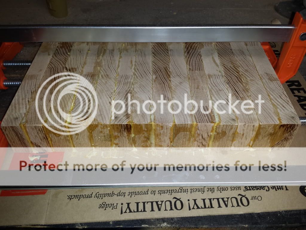

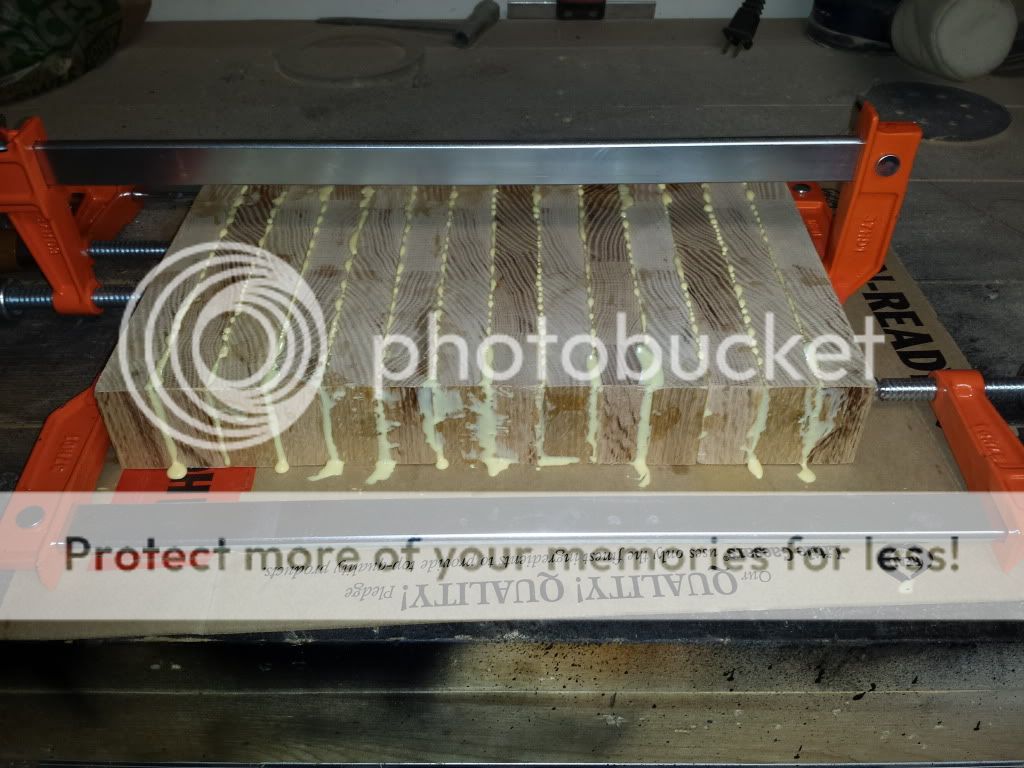

Its all oak, found some scraps on a jobsite figured would be perfect to try this out before I bought wood for a nice one. Heres progress so far. I don't have a table saw so boards are not perfect but I make it right with the handheld belt sander after dry. Can't wait for the next steps tomorrow. I am excited
4,801 Posts
Couple of things. Try and wipe off the squeeze out with a damp rag or sponge before it sets up, much easier. Or let it set just a bit and scrape it off before fully set. Second, oak is not the greatest cutting board material as it is too porous. Next time try maple or cherry. Be careful with the belt sander as it is very easy to create hills and valleys in your board. Otherwise, have fun and be sure and post pics when finished.
82 Posts
I thought oak was good for cutting boards because of it being so heavy I thought that meant tight and non porous. Oh well really the technique I wanted to try anyway since I got the wood free. I did let it set about 30 min and scraped most of the glue off. I don't have a planer or anything so I have to do the best I can with the belt sander then move to the RO sander. And I will post pics hopefully I have it done this evening.

+1 with Sawdustfactory, white oak is rather porous for cutting board, especially end grain. Red oak is even worse.
This is magnified end grain from Phind's excellent site.
http://www.hobbithouseinc.com/personal/woodpics/
Note the small holes, these are the open pores characteristic to white oak and some other species.
These have the potential for small food particles to be trapped.
Good learning experience.
