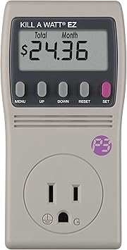

Get a watt meter like this to determine how many AMPs it draw under the different circumstances you propose:
Check for the name plate on the motor for the amperage rating.
Take a photo of it to post here.

I have the Harbor Freight "2HP" dust collector. It's actually, mathmatically, about 1.5 HP. I have a home made version of a Kill-a-watt monitoring the current. It peaks at less than 12 amps at startup and then runs consistently at less than 10 amps. It has never tripped a breaker on a 15 amp circuit.
