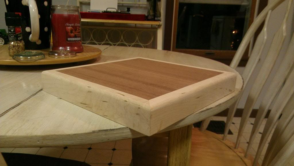

One more thing, i had a small offcut from the op 12”x12” that i wasn’t too sure what to make of it. turned into a napkin holder
