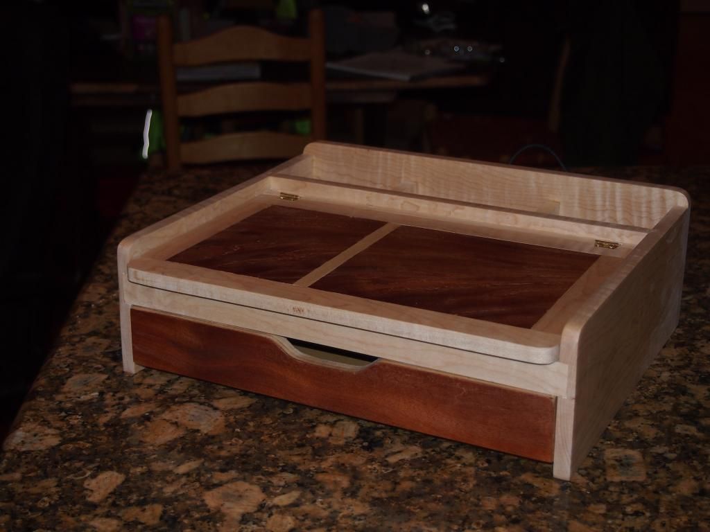

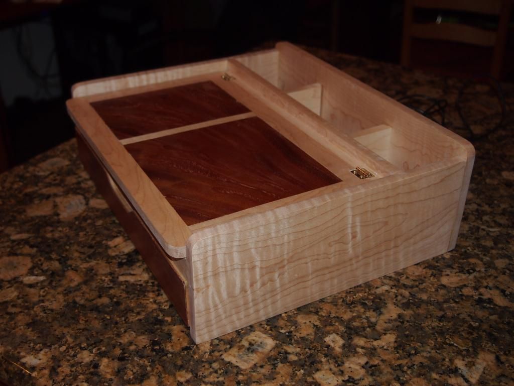

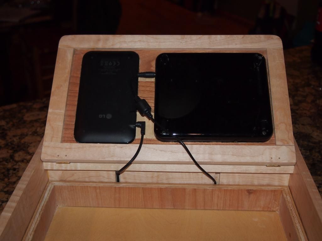

Friend of mine wanted a desktop organizer, and decided he wanted to make it a bit more modern by adding in some inductive chargers. Basically, you put your phone/laptop on top of the chargers and it charges the battery wirelessly. No cords to worry about, just toss them on and go. So, he asked if I could put it into a box. Ended up routing out the panel top to about 3/32” thick so as to minimize the amount of interference from the wood. I have no idea if it will work since I don’t have his phone/tablet with me, but it should. Theoretically.
Wood is maple that I found at Home Depot with some decent figure, and the panel/drawer front is Mahogany Crotch veneer.

That's nice. I've been needing to make something like that to store wallet, keys, watch, etcetera without the chargers. I like your design.

That is a neat design and if it was a little bigger, I could put my laptop on it, while I watched TV. My only question is, do the chargers get hot, and if so, are there vents to keep them cool?

I don't believe they get hot, and it is open to the drawer below, which has the cutout in lieu of a drawer pull.
Thanks guys. Hopefully it works. 3/32" was as this as I wanted to go with the panel without risking it falling apart.
