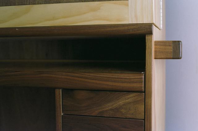

I'd like to get some advice on how best to approach a sort of vivisection of a piece of furniture, that is to say how to cut it in half.
The item is cross between a utilitarian piece and fine furniture. It was originally designed as a specific type of rolling workstation that wouldn't look too offensive in a domestic setting. It's a desk combined with a sort of hutch with large hinged doors which swing open to make 'wings'.
Now, I'd like to now re-purpose it for service as a computer desk (it has a nice full width slide-out keyboard surface) by removing the doors. Simple enough.
The problem is it's too big 24"(W) x 48"(L) x 72"(H) to maneuver down the hallway and make the turns into my office/study. So I'd like to cut the top section off at the level of the desktop, and then perhaps reassemble it once I get it moved into study. The case is made of 5/8" ply and the back of the piece is I think 1/2" luan ply.
I'm racking my brain on how to get a straight, clean, even, cut flush with the desktop (latter is also of ply).

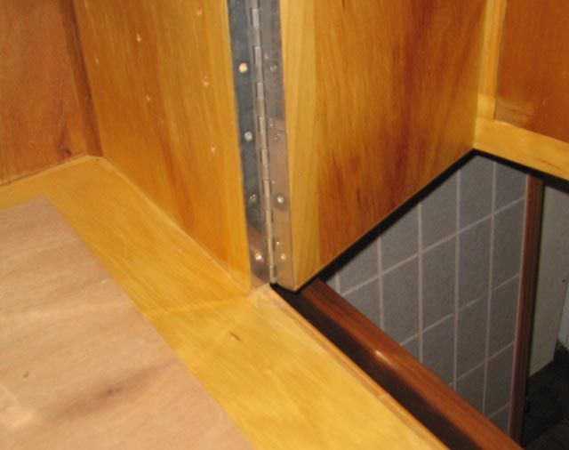

Then know you how it was constructed. From what I can tell the sides are made from one piece and I "assume" the same for the back...hence your dilemma. I see that the hinges that hold the folding shelves can be removed leaving only the "half" side and the back.
You can make a cut with a circular saw and a guide all the way around IF you know where to make the cut.....? You could use a framing square and transfer the height of the desk top around the sides then intersect the 2 lines across the back. Just to make sure, I'd drill a 1/16" hole on your line ..carefully .... to see if the drill appears on the inside above the desk top.
You can favor the cut to slightly above the desk top OR slightly below and count on a piece of trim to conceal the kerf. You would want to set the kerf to just the thickness of the side and back material which is different. I'd want to lay the piece over to better manage the saw and guide.
Next question ....which to cut first the sides or the back...?
If you cut the sides first, the back will hold it together if you support the sides at the right height. If you cut the back first, it will be less manageable, in my opinion.
If you favor the cut above the desk surface and there is an "oops", it won't cause any damage. Then you could use a router to trim the excess flush OR below the surface for a trim piece.

Yes, the sides and back are each made from a single piece of ply. As you've observed, once the hinges are removed the back is a 'half back'.
I like the idea of the circular saw and router trim bit. However, it's circular saw is one tool I dont own since my last one was ripped off many years back and never replaced, as I managed to get by without it.
Your sequence of cuts is also well thought out.
If anything gets damaged by the cut I'd prefer it to be the top, as the desk portion is more valuable and versatile to me, there's always an option down the road to use it as a stand alone desk by just adding some trim to the cut.
In my imagination I'd vaguely envisioned a sort of deluxe burly Japanese flushcut handsaw (like for trimming dowels) that tracks immaculately and cuts perfectly square ;)
