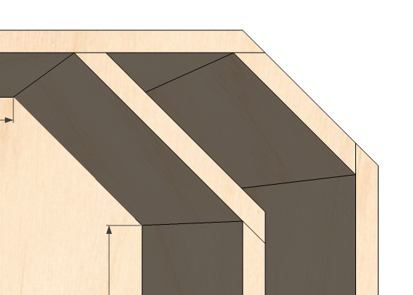

Hey guys I'm new to the forums and just looking for some advice. I have a project I'm working on and really not sure the best way to bond a particular joint or joints. I have a picture here for you which would be easier then trying to explain. thanks

Ah yes I forgot it's 3/4 "mdf. I have an idea what I'm going to do but I'm not sure yet since I haven't gotten a chance to try it so I figured I ask the more experienced. Btw I'm not talking bout like type of glue I'm wondering best way to clamp and keep them in place etc

I'm wondering why the pieces on the left are not configured the same as on the right. It would be easier to keep them the same.
As for the outside corner. It would be easier to clamp up if you leave the top and side long where it would meet at a 90 degree corner. Then you can clamp the inner piece to the outside and cut it off flush after.
