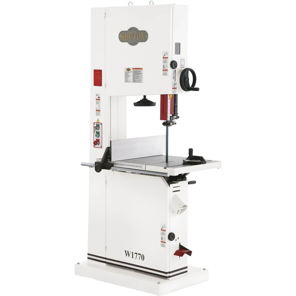

You might be surprised at what a bandsaw will do with fairly limited horsepower. It's a different animal altogether from a circular saw, and horsepower is much less of a factor. A 14" bandsaw with a riser block won't magically become a 18" 230-volt beast, but it will probably do the job. I have a friend with an even larger bandsaw who's not really impressed with it's resaw capability, so size and horsepower aren't always the most important factors. Using a good quality blade intended for resawing is crucial. and upgrading the blade guide blocks and bearings is where you'll probably spend money, particularly if you buy a used saw.
The bandsaw blade is already a "thin kerf" compared to a table saw blade.
These specs are from a 21" Shop Fox:
SPECIFICATIONS:
  • Motor: 5 HP, 230V, single-phase, 22A
  • Max. cutting width left of blade: 20"
  • Resaw capacity: 14"
  • Table size: 20-3/4" x 29-1/2"
  • Table tilt: 5° left, 45° right
  • Floor-to-table height: 35-1/2"
  • Blade size: 165" (1/4"¬–1-3/8" wide)
  • Blade speed: 4600 FPM
Notice the blade speed is 4600 FPM. That's really rippin' compared to a 10" table saw blade:
See post by contributor s which states the rim speed would be:
A 10 inch blade on a 5000 RPM shaft would be:
10 x 3.1416 = 31.416 x 5000 = approximately 155, 680 inches per minute.
Dividing that by 12 you get : 1296 SFPM.
Another online calculator here:
A 10" dia blade at 5,000 RPMs gives a rim speed of 1308 SFPM. by my calcuator.
So, a bandsaw is running considerably faster SFPM than a table saw
